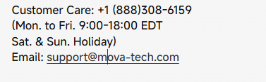

Based on your feedback, we confirm there is a hardware fault with your device. Please contact our after-sales team for assistance. If your device is still under warranty, we can offer repair service. Please prepare the model information, proof of purchase, invoice, SN code and fault description to help us process your request faster.
